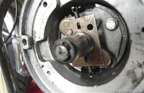

you have Paul you just don't know it, because the engines are quite forgiving and flexible, you are not aware of the ATD bouncing around all over the place giving large and small amounts of advance when its not needed or even when it is, and again, if the points gap is not identical , and you have not strobed both cylinders individually, it will still run just fine, but you don't know that the timing is different on both sides, those problems are there, but they just don't cause any grief, and why not, just carry on, you are not racing and every last unit of horsepower is not vital, my own SF experience in the early 70's reminds me that the points last about five years or 40,000 k's or miles (owner can choose), I always carried a spare and pre-set up ingnition backplate, but never needed it, the original system is so good on the SF it puzzles me why people do change it, but hey ho, I have even got a smart phone now, in the old days you had to stop and use a public phone box, every single time you got through unlike the smart phone which does not work when I am at home.
