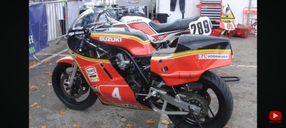

As I said at the AGM, smoothing out the sides, at the rear, would enormously reduce the turbulence/aerodynamic drag.
Maybe closer to the unit on the Heron Suzuki, rather than the cut off seat design.
