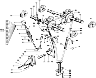

Remove cam chain support bracket.
This is the 2 studs, bracket only goes one way, make sure you mark which way it goes.
Washer should be easy to get, if it's not already sitting on the bracket.
Thomas, thanks, articulating scope coming. Marty, are you talking about the cam chain adjusting bracket on the back of the cylinder block? Good idea, thanks -

Ok! Which bracket are we talking about? Is the support bracket the mount on the back of the engine for cam chain adjustment? Thanks -

I can do no better than quote this (which I think was from you, Piet)?:
"The narrow, flush side, goes towards the alternator. Look carefully and you may find a centre punch mark on the top side of the pedestal semicircle on that side.
If you put it in the other way round, the wider offset shoulder will rub on the crank."
Or this, with the same message (and which I know was from Paul Leclair):
"Although it maybe not be immediately obvious, the curved part at the top of the cam chain support is "handed", being wider on one side than the other.
Have a careful look at it when you remove it. With an engine this old, you cannot assume whoever installed it last put it in correctly.
The narrow side, flush side, goes towards the starter side of the engine."
