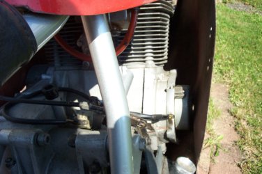

The Phoenix has risen, Humpty Dumpty is back together again, with assistance from neither Kings horses nor men... ;)
Wanted to start up last week, then found out the 20W50 barrel was empty. :rolleyes:
Oil arrived this morning, so I set to work. Ignition timing checked and carbs balanced, engine sounds very healthy. Fairing lower isn't fitted so I can better check for oil leaks, all good so far! Top end oil supply is perfect.
Only a short (crappy)vid, camera battery was low and I'm no Stanley Kubrick...
View attachment DSCN2111.MOV
Nürburgring event is go!:)
Certainly has been a challenge, it's taken me to ground I've never ventured upon before. But, it was all pretty basic engineering that just required thought and patience.
Although no Kings' horses or Kings' men helped, I did recieve quite a bit of outside assistance for which I'm extremely grateful. My thanks go to Werkzeugtechnik Schmitz in Troisdorf for their patience with the welding job. Harry Schröder of Schröder Mechanische Werkstatt GmbH for the machining job of the upper crankcase. Andy Wagner from Laverdaparadies for the donation of a pristine set of SFC pistons and barrel. To top it off, our own Quentin Frayne from Melbourne for his generosity donating a pair of SFC conrods!
I guess this chapter and thread can now be wrapped up, see you at the Nürburgring!
