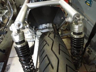

Next on the list is replacing the modern rear shocks with a pair of period Ceriani GP items that I have been able to source. The shocks were in a sorry shape and require a total overhaul, of course seal kits are no longer available, so these will need to be made up. The shocks are the De Carbon type with a floating piston separating the damper oil from a gas charge. As I don't anticipate finding anybody capable of re-charging these, they'll be rebuilt as simple oil dampers. Reckon they should be fine for a couple of demo laps here and there.

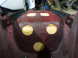

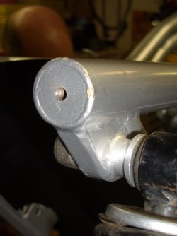

Just a curious question Piet, what stops the seat/tail unit from falling off? Looking at the undressed picture and Marks pictures, I can’t see any telltale fixings?
There's an angled bracket laminated under the seat that snuggles up to the end of the top frame rails. These have a thread at their blunt end into which the angled brackets are bolted. Front of the seat is held by the ubiquitous Laverda hook system. Quite clever and invisible. ;)
That’ll do it, can see a thread hole now that you explained it….. 😎
🤔 I reckon I’ll borrow that idea, but with 3C type seat slots in the angle so it lifts off the loosened screws
Thats how I fixed my SFC rep seat on my 3c, its loosly snuged and held on with a flat 25mm alloy strap cut to resemble a hook that rotates on the same seat bolt all 3c use

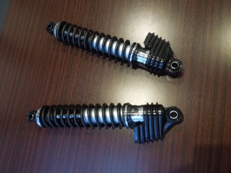

As previously described, I've found and now overhauled a pair of Ceriani GP rear shocks. One was leaking and devoid of damping oil, the other hardly budged...
They're pretty crude and hold less than 75ml of oil, stock Cerianis on 750 Laverdas contain 100ml, maybe there's a reason they're so rare these days! ;) The one-piece rubber oil seal was substituted with an alloy collar with an o-ring at its' circumferance running in the damper tube and an oil seal together with a dust seal for the damper rod. Rather straightforward actually. The dampers only started showing anything like dampening action when the 10W fork oil I started off with was replaced with straight 50W motor oil! I omitted the floating piston originally seperating the damper oil from a gas/air charge, the oil content would then be less than 50ml and the piggy-back chamber would contain only gas,usually nitrogen. For now, they will rely on oil alone as I have no idea how they are pressurised, nor do I know of anybody that is capable of doing so. There is only a simple plug on the chamber, no Shrader valve or aperture allowing charging with a needle.
Anyway, I'm pretty chuffed how nice they came out, even if they're probably far from top-notch equipment. They will at least give the bike a further period touch and I can finally return the YSS that my mate Dirk graciously lent me 10 years ago...:rolleyes:

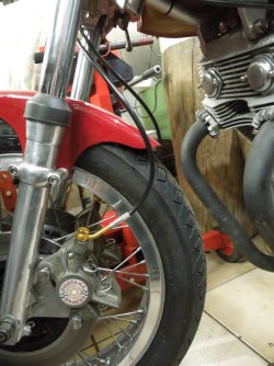

I also replaced a couple of brake line unions that were more-or-less last-minute fittings back in January 2017. The calipers have a rather uncommon 3/8-24 thread, not much of that to be found in a workshop dealing mainly with M10x1 hydraulic threads. M/C on the other hand, has M10x1, wtf was Signor Fontana drinking that day? Front lines now have a far more pleasing flow, rear no longer snakes around the swing arm pivot and also looks a lot tidier. Unfortunately, the Fontana front M/C no longer creates/holds pressure, new seals are on their way. This stuff is thankfully still readily available as Fontana based their caliper and M/C dimensions on the established Lockheed hydraulics of the day and the seals are found in an assortment of '70-'80s brit bikes such as the Norton Commando and Triumph Tiger and Bonneville. Just a shame the available seals are of crap quality and don't last longer than a season or three...

Splendid resurrection, Piet. Did Fontana make their own calipers or just rebadge Lockheed or Girling (I think that's the name, as used on early 70s pommie bikes, Rickman etc). Thought the TPI imperialismo thread was a bit odd for Sig Fontana.
Definitely their own design and manufacture, Quentin.
All piston diametres are the same as in Lockheed and Girling, as are the seal fitting dimensions. Possibly a cost-cutting measure. Using imperial threads may have been a part of that as well as a wide variety of fittings would have readily been available off the shelf, instead of re-inventing the wheel.
Bike is equipped with Fontana hubs and brake discs as well. Hubs and disc carriers are magnesium alloy.
