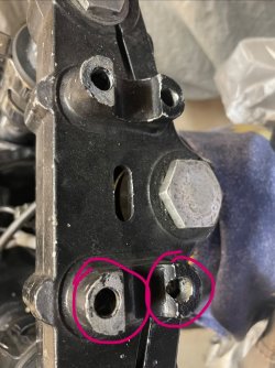

I brought a set of NOS Ceriani yokes from a major parts dealer for my Motodd. The top yoke stanchion bore was about 10deg out of alignment to the L/H side. I ended up reusing the original one I had fitted years before after welding up a couple of cracks. That one probab ly camed out of the reject bin.
Marzo Monday clamp?

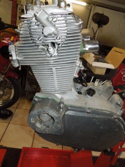

Been pretty busy sticking the engine back together...

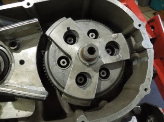

Aligning clutch plates.

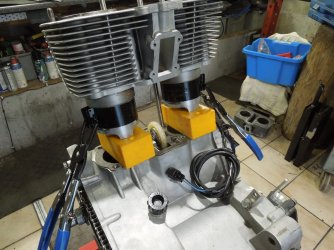

Dropping the barrel

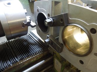

Then a little surprise popped up, something I'd completely overlooked. The liner spigots were far too tall at 4.2mm, the intact original only had 1.7mm, just enough to hold the gasket in place and to engage with the head recess which is at 1mm. This leaves a gap of 0.3mm for gasket compression. The head has apparently been drastically skimmed, probably to bump up the CR a bit. This called for a little creativity on my part as I no longer have a mill to my disposal. Thankfully I have a large angle plate that fits to the cross slide of my lathe. A couple of long studs, spacers and parallels and carefull aligning later, I was good to go. Stuck a turning tool with carbide bit in the 3-jaw and slowly attacked the spigots. Taking off 0.30mm per pass, took me a good 2 hours... but they came out perfect.
Improvised fly cutter
The remainder came together nicely, all bits and bobs were still in the bags and containers I had stowed them in 8 years ago.

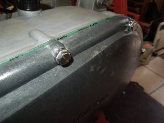

Made some pretty bolts for the covers
Still got other stuff to get out the way but I'm hoping to install the engine this weekend.

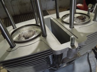

Hi Piet, looking amazing and I know you know what you are doing. I was just curious if the valve pocket on the right hand piston for the inlet valve is actually as damaged as it looks on the pics or if just the pics are missleading? I zoomed into the picture and was wondering if this is a real damage and if it could cause a heat nest eventually?!? Pretty sure you looked at it and it is just my missing knowledge and understanding, please.
Wasn't so sure at the beginning... ;)
No damage there Lothar, just some carbon remnants. I just scrubbed off the easy-to-get-at, figured it'll coat itself again quick enough.
At first, I thought you’d have to press the liners out to turn them down, but you found a clever workaround for the issue at hand - kudos!

Cylinder head has not yet recieved final torque as new shiny special head nuts are on their way. Those ugly, makeshift nuts are destined to the scrap bin...

Once the liners are removed, they cannot be replaced being certain that they remain as they were. Chances are there will be dents and bulges where there weren't any before. They would at least have required a light hone. Besides, the clock's ticking, so I was eager to get it together without further drama.
I have a mate with a dyno in a neighbouring hamlet, hidden in the woods Shakedown through the valley does sound tempting though. 🤣
