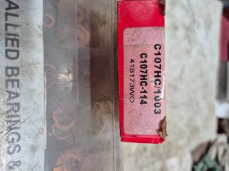

Here you go Lothar, brand new Regina cam chain, 114 links

I visited the Agostini Moto Guzzi emporium in Mandello del Lario a few years ago hoping they'd have a huge roll of C107HC in the back of the shop. Sadly, all I got was a shrug of shoulders and an explanation that the timing chains for the little Guzzis came from the factory around the corner already in their blister packaging, they were in short supply and that when they were gone, that would be it... Actually, it seems the strange size used to be quite popular, but with anything mechanical progressing, the size has by now simply fallen through the grid. Much the same as M7, M9 and M11 threads, quite common in the 1950's-60's, especially in regard to italian and german vehicles, pretty unfavourable now.
Setting up tooling for just a couple of yards of these chains to satisfy a handful of tragics world-wide is mind-boggling expensive. Only way I see it happening is if some rich Laverda-loving humanitarian nutcase with money to burn sets his/her mind to it. I actually know a couple, but they don't have THAT much cash to burn, this issue has already been extensively discussed. China may be an alternative if you're prepared to take 20000 metres.;)
Why have I seen a couple of posts saying Dam Laverda have 668 and 750 Zane Cam chains? That's a bit hard to believe. Red, you should contact one of the high-end Auction Houses; you might be able to finance your retirement with that chain. Yesterday I was looking at world record autined Art numbers. If you can get a couple of hundred million dollars US for an Andy Warhol, what's a Zane Cam Chain worth? BTW, I was once asked to hang an Original Campbell's Soup Warhol in a holiday house at Palm Beach. I had no idea what that was worth. These are mind-numbing numbers
