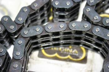

Clem, I use triplex chains in all my engines except the RGS and the CND850 because they have modified sprockets for 2 x single row chains.
Regina’s reputation was harmed due to the bad quality chains that do have a tendency to break. These can be recognised by the big pins. If you have one of those it’s better to replace.

BTW, the pins do not transmit the power, it is very misleading to think the thick pin Reginas were stronger than others. The side plate cross-section is where it all happens, the smaller the pin, the higher the tensile stength of the chain. If a chain lets go, it will be where the pin passes through the side plates, I have yet to find a sheared pin. Think about it.
