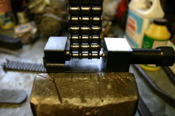

triplex primaries
just had a thought, if I do five of these, and join up the off cuts I will have a "FREE" chain!
probably have to admit that the saving of something like 80 quid over buying the Commando chain for under fifty (instead of 130+) is unlikely to encourage more to do it.
