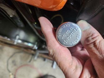

An old issue (about two years past) resurfaced a couple of weeks ago, but with a new twist and I'm stumped this time.
The turn indicators no longer work properly. Last time, a new relay solved the problem. Not this time.
Symptoms: motor not running: indicators have full function (×4)
Motor running: after a few moments, no indicators.
Motor off, ignition back on : full function again.
I can repeat the cycle ad infinitum with the same results.
All bulbs (including warning lamp) test good.
Switch obviously works correctly.
A new relay doesn't change the problem
Any thoughts?
Thanks

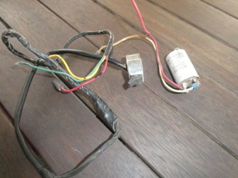

I was lucky with the AE. When I got it, it had a correct indicator switch wired to a flasher unit held by spring clips inside the headlight shell (pic). Can only presume it came with this set up in case someone wanted to fit blinkers. There was some other bunch of wires that weren't connected anywhere (although can't quite remember now) I just took it all out when cleaning up the wiring, but do plan to use that switch, not sure if the flasher unit will be much good with those little leds.
Sorry to OP for continuing the thread hijack😟
