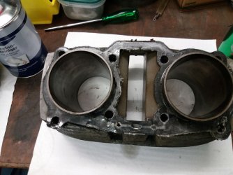

no kidding! still haven't figured out what this grey, rock hard s*#t is. Real PITA to remove....
