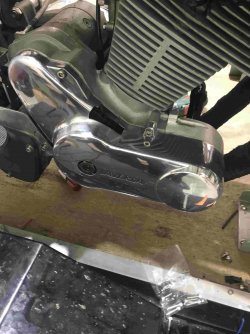

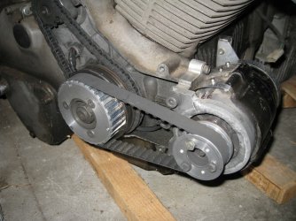

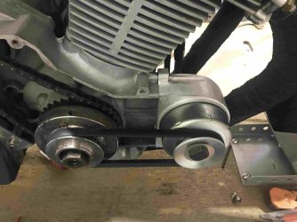

I think Chris K fitted a little mini thing to his SFK. I swear by my GPX1000 Kawasaki ND alternator conversion. I run it at 1.75 x crank speed, and used a Gates belt - no idea if a V-belt wouldn't just spin once on load. Not a simple fit though, as I weather proofed it while retaining some air cooling.
Ignore the filthy motor - std cover still fits but chamfered the inside front edge a little.

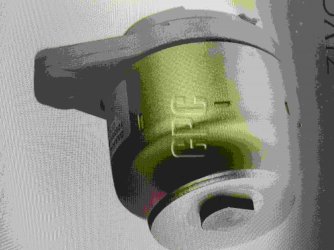

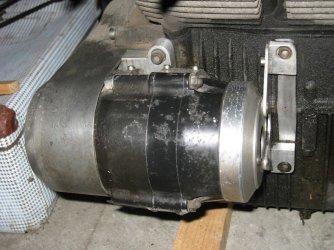

Chris told me that he faced problems with his tiny thing.
Iirc he swapped it for a GSXR item.

Chris Kay getting me to do his dirty work for him (resizing)!  ;)
