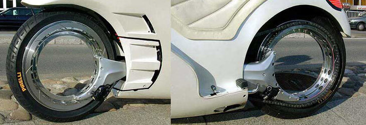

Saw a couple of Buells yesterday at the Bike Shed show...you may recall they use a single rim mounted disc. Looks funky...is there an advantage to that design? As far as I know nobody else uses it?
If you want to stop a spinning wheel, you grab it at the outside edge rather than somewhere close to the axle. In the same way, a large diameter disk will give better stopping power than a smaller one. Having a disk bolted to the inside of the rim is about as large a diameter as you can fit within the wheel.
The downside of a brake disk bolted to the rim is that it's easily distorted. If the rim is knocked out of line by hitting a pothole or some other irregularity, it'll likely affect the alignment of the disk. A fraction of a mm runout in a brake disk will affect braking performance and will be felt through the brake lever.
Hub mounted disks are much less likely to be knocked out of line.
