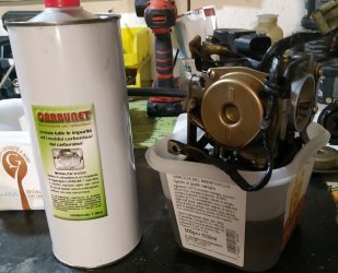

The most powerful and simply fantastic cleaner I’ve ever used is Carbunet, I found it at a motorcycle fair, and I can’t find it anymore— even the seller is gone. I still have 2 liters of it at home and I use it sparingly, as if it were 100-year-old aged whisky. Brass becomes like new, and its degreasing power on aluminum is exceptional without attacking the metal.
Here is a collection of images from a job on a Mikuni, tThe last image is the product’s can, while the container is a vanilla ice cream tub—this one just as essential!! 😄
