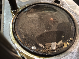

Zandvoort, isnt that smething like "on sand"? in UK speak?
not quite sand yet, still in rock formation, waiting further grinding
ouch that looks very abrasive.
