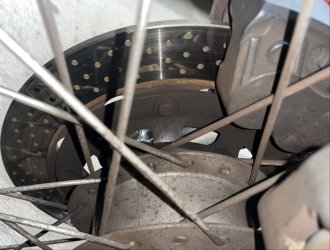

Of course, this is. Jota, but these are 4 potters too, needing fork legs swapped and a longer Speedo cable to get them being the legs, which some prefer.
