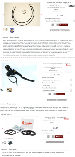

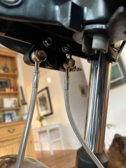

I'm ditching the splitter since it can accumulate air bubbles and 2 lines is a more direct path. Also, the existing Spiegler single line to the M/C is too short and doesn't allow the bars to be moved back closer in. The new Brembo M/C has a micro switch for the brake light.Why are you ditching the splitter? It won't haver anything to do with your wooden brake issue and you'll be losing your brake switch.
