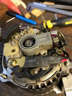

Pic shows new reg in place. I've emailed RM Stator to request that if the reg is faulty, warranty still stands, as the modifications I made were necessary to allow fitment (which they guarantee is a straight fit) ... and this was the last one in the country ... at a paltry A$210. Not happy.

Crikey the four soldered wires look awful to me! Did you use lead-free solder?
cheers,
bazzee
Thought the same, without disrespect to Q. 97% tin solder does not have a plastic transition state, sets like a snap frozen pea. Unnerving to see the effect when hand soldering. Perhaps the flux burnt off to soon.... though looks more akin to too lower temperature of the hard to solder extensive copper thermal conduction path. Speak for myself, been soldering for better than 56 years. Hard not to notice joints like this.....j
Yeah, I looked at that after I'd seen the nice blobs on the scungy GPX750 alternator I scrounged the test reg from.Looking at it now, it's hard to imagine I did such a shitful job. Maybe in an earlier life it's had the rec or stator replaced by some hack? But I'm certainly no dab hand at soldering, so highly likely that I'm the culprit. If it is my ugly handiwork I'm guessing I had to empty the housing for machining and welding?
Luckily it hasn't been problematic over the maybe 30,000km+ it's done on my bike/s - could easily be more ... too long ago!.
