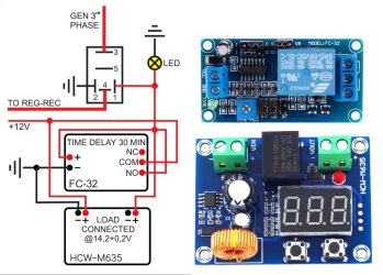

Here I go again. I’ve been struggling with voltage issues on my Jota for some time now. I have Nippon Denso alternator, Shindengen FH020AA mosfet regulator rectifier and a Lithium battery. Most of the time voltage is OK, somewhere between 13,8-14,2V. But when the battery is fully charged, the battery monitoring system steps in and protects the battery from being overcharged. BMS seems to completely cut the charging power to the battery, and this causes trouble. It results in unstable voltage and nasty spikes. Note, I wrote: “BMS seems to”, and that is what I meant. I have no actual knowledge of what is going on.
Anyway, I have checked and rechecked every wire and component which have something to do with charging, all good. I have always thought that FH020AA reg-rec would be compatible with Lithium batteries and it’s charging power would be about 14,2V. That is the value I initially found somewhere in internet. I recently rechecked the value and found out that it is 14,5V, which is too much for a Lithium battery. Who knows what’s the actual case. So, I ended up buying a new RMStator Lithium compatible reg-rec, and I hope it will finally resolve all the voltage issues I’ve had. The charging power is stated to be 14,2V. I hope that is the actual case. The results remain to be seen, on season 2025.
But if things don’t work out, I have a backup plan. It involves some extra components and new circuits. Basically, the idea is to cutoff one phase from alternator when the voltage gets too high. And then to reconnect it when the voltage is in acceptable level. And this needs to happen automatically. The attached picture shows the system. It is tested on bench and works as intended. But I hope I don’t need to go this road…
How does the time delay assist here? I would have thought the relay is controlled by the rising/falling voltage level. Your knowledge of electronics is far superior to mine, I'm trying to keep up.

Then the matter of my backup plan. It is a bit difficult to explain but I’ll try. As I said, the final solution would be messing with one of the alternator’s phases. It is not optimal or recommended, but if nothing else works, that would do it. So, one phase would go to reg-rec via a fife pin relay. The relay is operated by the two modules shown in the previously attached picture. HCW-M635 is an undervoltage protection module, but it can be used for overvoltage protection as well. What happens is that HCW-M635 is always on and monitors the voltage. It is a programmable unit and I have set it to 14,2+0,2V. So, when the voltage is below 14,4V, the module does not feed power to the load. When the voltage is 14,4V or more, the module feeds the power to the load. On the load side I have the relay for the phase. The power from HCW-M635 is used as an impulse power to the relay, so it pulls when the voltage is above the set level. And what happens; Voltage below 14,4V – relay doesn’t pull – phase is active – pins 3 and 4 in use. Voltage above 14,4V – relay pulls – phase is not active – pins 3 and 5 in use. This would result less charging power from alternator and voltage would start to decrease. Without a time delay module this would probably happen constantly, so it is there for a reason. At the time voltage is too high and HCW-M635 feeds power to the relay, also the time delay gets power. It is connected in such a way, that the phase relay stays active even if the voltage decreases below 14,4V. I have set the time delay to 30min, after that it “shuts itself down” and the alternator’s phase is active again. I hope that made sense.
