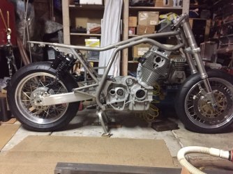

A bit more progress on the SFQ ... modern alloy swingarm squeezed in - wheelbase back to std to compensate for 25 deg steering head angle.
