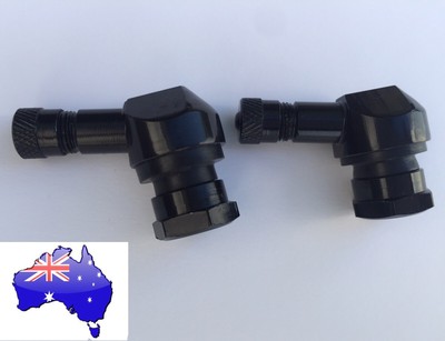

I have a habit of wanting stuff that never existed. What set me off this time was seeing one of the newly finished Laverdas on last weekends ride sporting a 90deg valve attachment, but it was a cast wheel so it's probably been converted to tubeless with a bolt-on 90deg valve. It looked incredibly easy to get at so I WANTED ONE And then while on another site a read a post where someone was inferring that having 90deg valves was easy on spoked wheels and showing 2 pics. One with a straight valve std spoke design and one with a 90. BUT the 90 was on a BMW rim with outer rim type spokes that run tubeless so that also was a separate bolt-on type valve and that's what I said and added there are NO 90deg type tubes around. And then someone said he had exactly that on his bike. And off I went looking. The problem was his bike ran 16-inch rear wheel. So here I am wanting something that doesn't exist again.
Well, I could convert my spoked rear wheel to tubeless and use a bolt-on 90. I first heard about these conversions being don't by Woody Wheel Works on big Adventure Bikes out of Colorado in the USA years ago. There are concerns that Borani style rims are not designed with the lip that holds a defeating tyre safely on. We do have experimenters who have done it here in the Sydney Laverda Club. I am a bit leary, mucking about with deflating tyres on group rides is a nightmare as we found out recently. It takes a lot of tedious work to seal completely, but now I have stable spokes, checked recently with my Spoke Torque Wrench I might do exactly that.
What? You'd convert a poke wheel to tubeless just so you could run a 90 degree valve stem??

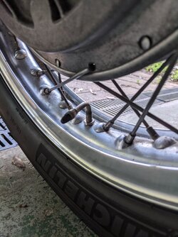

Sf2 enduro converted to tubeless with a right angle valve. Now you really want one don't you Vince.......
Conversion has been tested for 5000km now, no problems.

I have a 3.00 Morad rear rim instead of the std 2.50 Borani, don't know if that reduces or increases access to the standard straight tyre valve. I have easy access to adjust tyres at home with the gear I have so this isn't urgent especially with a new rear tyre. Marty is your 90deg tyre valve 8mm or 10mm and where did you get it from. Good to know the rim profile allows these to seal and bolt-on.
What's the trick to getting it to seal inside? There is/was a place called Jupiter heels (IIRC) that did tubeless spoking and they had a trick o-ring in the spoke nipple itself.
