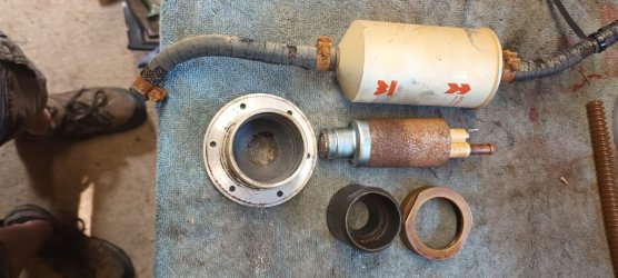

Pump etc out. Picture tells the story. Hoses disintegrating, rust from the pump body had clogged the mesh filters and probably wrecked the pump.
Now waiting for new parts.
Didn't need to take the tank out. Bit of a fiddle to get the pump and filter out as the hoses are like concrete. Hoping for easier re-assembly.

Has all the effects of external grade fuel hose being used internal, misapplication. Internal fuel hose is expensive than external appearance identical to the naked eye. Pump internal will free up if it can be partially dismantled, and mechanically moved and lubed. HTH J
New pump ordered, not worth taking a chance on the old one and it doesn't look like it is servicable. Plus all that that pulling appart again if it fails. Proper submersible hose ordered which is more expensive than ordinary fuel hose.

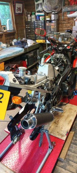

Prudent to use new where it is a nett gain, though have redeemed 4 pumps now, with partial disassembly ( have a very good home workshop and tooling ) matter of most effective considered rectification, one replacement pump was in excess of $300, rectified seized original remains working to this day. Granted, the pump in the photo does not appear to lend itself to rectification process of any merit.
Did on my TLR move the internal inline filter to the outside of tank, using a higher quality filter element, for just the reasons you intimate, access and improved reliability.
Not so aligned to the premise of "Rust" comment, more the matter of modern fuel soup interacting with the metal and plastic parts submerged in fuel, producing a surface adhering sediment which can produce free floating particles that contaminate filters, primary on the pump intake and the secondary post pump to fuel rail. The primary filter contamination will cause the pump cooling to reduce and possible failure, though i have not seen a thermally damaged pump yet, by way of dry running operation as the control system shuts down the pump or the motor stops working due to lack of fuel pressure. Nice workshop BTW, HTH j.
