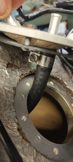

Pump in. Lots of practice runs to make sure hose lengths are OK.
I found that I had to use a spare piece if hose as a draw rope to find the end of the new hose(s)
What I couldn't understand was how the original hoses were too short to fit to the end of the pump out side the tank?
I then discovered by accident that the filter goes through the hole in the baffle in the tank.
Once I had got the filter through the hole, more fiddling, suddenly there was enough hose at the bottom of the tank to attach the pump to the hose. I then pushed the pump and flange into the tank and fitted a couple of screws to hold it in place.
Once the pump/flange is attached to the tank and the filter is back through the hole in the baffle plate there is enough hose at the top to attach the top flange.

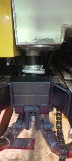

The other thing that has been puzzling me is that some are saying that the tank needs to be removed. In my case I didn't need to do this to gain acces. But are some tanks different?
I've attached a couple of picks to show the top and bottom 'flanges' which I have gained access to by taking out the rear wheel etc and the fuel injection body.
So it's going back together.
Hope the above is of interest and perhaps of some help to others.
