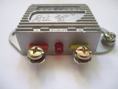

This cheapo Chinese VR has the same D+, D- and DF connections so it appears to do exactly the same thing (although not adjustable).
It might be rubbish but worth a try at that price. I've bought some dirt cheap stuff out of China that's been surprisingly good.
Find many great new & used options and get the best deals for 12V INTELLIGENT GENERATOR ELECTRONIC VOLTAGE REGULATOR REGULATION at the best online prices at eBay!
www.ebay.com.au
If you're concerned that the Chinese one can't be any good for the price, there's no reason an electronic VR should be expensive. They only have about $5 worth of electronic components in them - a couple of transistors, some resistors and diodes. Solder them together, shove 'em in a box and fill with potting epoxy. Job done.
Any factory that can't make them for under $20 is doing something wrong. Selling them for $176 is profit gouging to the max. Welcome to the free market economy where things are worth what some poor sucker is willing to pay.
