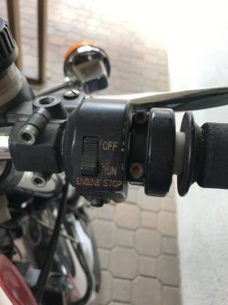

I want to ditch the 1 into 2 carb cable splitter and install a dual cable throttle, but need to retain a starter button and kill switch, so what have others done?
Thanks

thanks, but I find that the cables can easily pull out from the splitter and cause carb issues. many vintage Ducatis use dual throttle cables without any issues.unfortunately the routing for the splitter gets tangled by the other misc wires. I,ve tried securing the splitter w zip ties but it doesn’t help, so I,ll try the dual cables.
my main question was what to use in place of the OEM pod for the starter button/ kill switch which was kindly answered previously.

I've got an original SF1 Tomaselli twin throttle I'll happily sell you - If you insist on going this route. One alternative is to grind out your ND throttle to cover the clamp section of a non-starter-button throttle. Personally I prefer as little bolted to my bars as possible.
