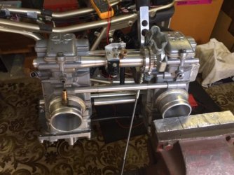

I bought a Tomaselli dual throttle w appropriate cables and installed it, and the single cables now route directly to each carb without the cables hanging up w the splitter and jumping out of the splitter or carb body tops. BUT the throttle body housing doesn't have the same adjuster mechanism as the single cable, so there's not enough slack in the cables, and there's not enough free play in the cables as needed. It's got a spring loaded adjuster screw that doesn't do anything, so if anybody has experience w this, please chime in, or I'll go back to the horrible single cable and splitter.
You might have cables for a 30mm carbie, which would have shorter travel, so less free length. You could attempt to cut a little off the outer casing but that's definitely not easy without damaging the inner wire. The consensus is that you should really have persevered with your one-into-two - a NOS splitter surely would have worked fine. Properly set up they have none of the problems you've experienced with yours.
I got rid of that 2/1 splitter on my US spec SFC installing an original Magura throttle and twin cables. Never looked back.
Your nearly there Teddy. I buy Venhill make your own cable kits that will have every thing you need. Made a small solder pot to solder on the nipples. Ignore the distractors. Nothing wrong with twin cables.

I'd fit a single throttle cable with splitter to the Vinnie, if only to tidy things up a bit. I've neen told these were actually a Vincent factory option at some stage... single pull;
I see it now, thanks. Guess you'll need to be carefull rolling over a curb.
Wondering for how long I can kick the Matchless to life, electric legs for them are quite complicated and expensive.
Twin throttle cables with adjusters make synchro easy. :)
