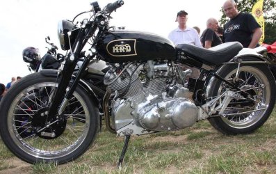

Like this one, Vince?
The ones that come down from behind the rear wheel require somehow holding the bike up while using the stand right behind the rear wheel. There are 2-man jobs to be sure the bike doesn't tip over. And it's the same once the bike starts. I think I remember seeing a Vincent centre stand that was in the middle of the bike but had a long vertical hand lever that swung rearward, making it incredibly easy to use.
I don't quite get the mods on that Vincent, Hamish. I can't imagine what the rider looks like on it, legs contorted in some sort of yoga pose gone wrong, with about 2 inches between pegs and saddle!! The term 'rearset' takes on a whole new meaning when the pegs are almost on the rear axle! Is what's called 'ergonoNics'? Maybe the owner is a cross between Tyrion Lannister and Michael Jordan? A very odd thing to do to a Vincent IMHO.
Yeah, and just look at the angles of the axle tommy bars! ;)
That's a series D stand. I tried one last weekend. Very easy. I've picked one up for when I get old.

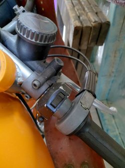

Good points Gerald. While I never had a prob after I went the other way (SF1 twin cable to SF2 split) I can accept that it isn't for everyone. My comment was more about relocating the starter button-kill switch. There were alternative ways to retain the ND switch shown on here. Failing that there are other narrow start-kill switchblocks that could have been squeezed in to enable use with the right hand still on the throttle. Not my bike so doesn't matter anyway.
I forgot what bike, but the issue I had using a splitter was that it required one precise method to assemble the cables, or you ran out of adjustment to get them fitted. The simplest solution is usually the best.
Teddy, you could have brought a CBR250 starter/kill switch for fuck all from a breaker or even ebay.
On my 750 I cut the throttle section off the switch halving it's width.
On my triple I use a CBR250 unit.
