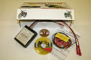

It has a Boyer mirco_mkIII ignition system (Not fitted by me), with a duel outlet Wat Yong coil, (which in itself does not fill me with confidence, but what do I know, it might be the Ferrari of coils)

Yes it is a pointless ignition system, i have tried both plugs plus a new one all work on right side, but not left, it is a duel one pack coil with a single wire to each of the secondary connectors.
I have tested the secondary circuit which gives 1.9 ohms, but can get no reading on the primary with and without the sparp plug caps fitted

Try swapping the ground wires on the coils - That is see if each coil will fire a plug - if not I would suspect a bad coil side or bad spark plug wire. If it does fire I would suspect a bad Pick Up Trigger , Wires to and from the ECU Box or possible the Box itself.

I took the dual coil off and decided to see if I could remove the HT lead to the non sparking cylinder, well apparently they're not replacable, so thats one knacked coil.

You can't drive a dual output coil from two sets of points. The same goes for a pointless electronic ignition. An electronic system fitted to a 750 twin will normally have two pickups (as stated in the original post) and two coils. Although different configurations are possible with smart electronics.
If it really is a double output coil and wasted spark system, then it either has two lobes on the ignition rotor and one of the pickups is redundant, or the two pickup signals are somehow sorted out in the electronic box and fire the same coil. I know nothing about Boyer ignition systems (and there's bugger-all info on their website) so it could be either of those alternatives, or maybe another that hasn't occurred to me.

I've ordered 2 (Its how they was listed) Tek Mp08 coils , (ex VFR) from eBay, will use the best one, and new HT leads, for now, to save me having to fabricate too complex a method of mounting, if that does not solve the problem then I will test the pick up coils.

Electronic ignition on SF can have two pickups and a single lobe rotor and each pickup firing it's own HT coil. In this system the plug leads must be on the correct side for TDC compression. Alternatively it can have a twin lobe rotor and one pickup that fires both sides at once - a wasted spark system - and both plugs fire every time the pistons pass TDC (as per the Ignitech I have on my street SF2, and the Sachse system I recently fitted to a friends bike). I am having trouble understanding why Boyer would have two pickups and a twin plug coil. With only two wires to the pickup plate it would seem to be a single pickup system but I have never seen one so maybe they have some weird electrickery in that black box. It will be interesting to see if a new coil fixes this bike.
A 500 Laverda has 180 degree crank and has to have two pickup system with two coils.
