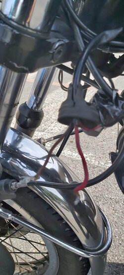

So I went around the wiring, pulling and wiggling. I was very close to giving up after about an hour when wiggling under the instrument console flashed the idiot lights on. It turned out that one wire was parting company with the ignition switch.
Rip the wires off, brown and red together and we have lift off for the 300 km ride home, looking like thieves at every stop when stopping involved separating the two wires and starting, joining them again.
