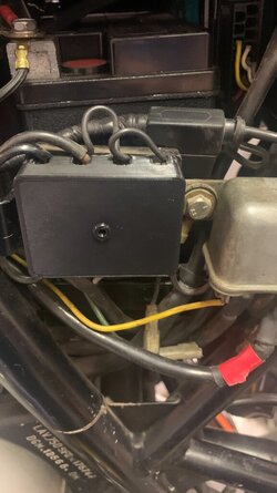

Not a useable part but it will work as a fit check for a machined version. I may thicken the walls and use a better material
Try printing it in ASA. That will print on most printers. Helps to have a heated print bed.
It’s a good tough material. If your printer can print ASA I have had the best success and finish with Ploymaker Polylite ASA.
Upgrade your print nozzle to a ruby tipped nozzle. 3Djake is a good supplier if you are in europe.

I bought an Creality Ender 3 V2...in fact I bought two refurbished units for $269 US. I've had one part printed by a commercial outfit and the second print off my machine was better ( filament was the sample PLA, part cost was 6 cents. - based on PLA+ I bought) The filament cost for the fuse box was 63 cents, I used the cheap filament that came with the machine. I had lamination problems on the fuse box. so the settings need some work. I changed the filament and will print # 2 and probably #3 #4 to tweak the recipe

For Andy's shipping cost I can print 20 and I don't have to wait...AND I'm having fun!

V2 much improved but I want to print support that easier to remove. The strength is vastly better with the PLA+, although the ASA will have better material properties for this application. V3 coming soon...I need to work on a knob
the PLA + is good for prototyping but will go soft, make a test piece and leave it on the dashboard of your car for a day or two and see the difference, it's great for models and architectural models etc. The other one you can try out is HIPS as well, that's a great filament and is good with impacts, there is a bike builder out here who has done some amazing prints with it for end-user use.
Make sure you read your filament tech sheets once past testing designs with PLA, you need to aneall most plastics in the oven, it makes the final product much stronger, mostly its around 80 degrees Celcius for a few hours. When I am prototyping things I print in polymakers PLA terra, which is a biodegradable plastic, its made from cornstarch and beets etc, and breaks down, saves putting plastics in the ocean etc.
