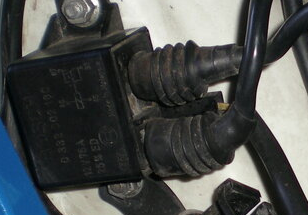

These black gadget with the 2 thick cables is what got hot. One goes to the battery and the other cable goes into the engine around what looks like the starter motor. If its a starter Relay why would there be 2 cables?DSCN0477.JPG
Hello Vince,
4 wires go to your starter relay (the 2 thin wires control the coil, 2 thick wires supply the starter) - see the wiring diagram on the relay.
Caution - very high currents flow when starting, both through the relay and through the starter motor - both become warm/hot!
So do not try to start the engine for too long at a time.
