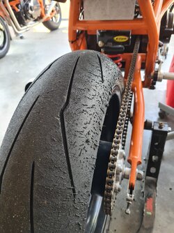

Veloce's rear tyre, brand new this meeting, used her to qualify
17" x 160, SC1 compound, brand new for qualifying and only done 5 laps so around 15 klms
Can easily see what we have been dealing with, edge grip is missing
This is normal wear for our bikes for the last 6 race seasons

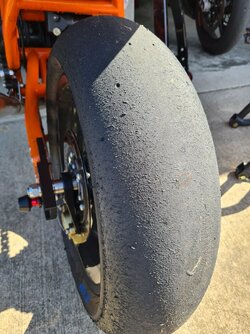

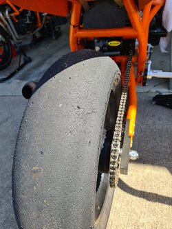

Mule's SC1 x 17" x 180 rear tyre, after two practice sessions and 3 and a 1/2 races
Huge difference, tyre is gripping and driving out of corners instead of spinning up and upsetting the rear end
Can now see why Matt has been asking me for the last two years for a 180 rear tyre
We added two clicks to the compression on the rear K-Tech race shock and did not touch anything else though we can see we need to dial the new set up in a bit better as rear end is still moving around a bit coming out of corners, need more testing
Am really happy with the result, now need to machine all the bits to convert Veloce to a 180 so both bikes are the same

Tyre wear is very interesting ! Must be some influence from the difference between the pure slick and the semi treaded slick ?
