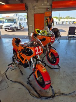

Tuesday morning, scrutineering done on all 3 bikes, passed easily
Ready for 4 days of practice
Between Matt's BMW and the Laverda's we have 8 brand new rear slicks and 6 new front slicks
Planning on doing a few laps
