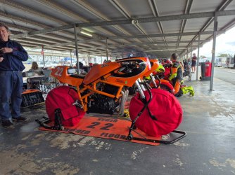

Both machines prepped and ready to race. And were loaded up into Matt's van yesterday.
All the best to Matt, Red and the crew.
