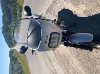

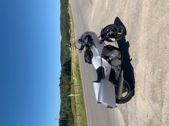

as I continue my medical recovery, I got the RGS out for its first ride of this year. Was riding with several guys on modern bikes, and spanking the wheels off the RGS. Hot day for us, around 30 ish C, rode a couple of hundred kms.

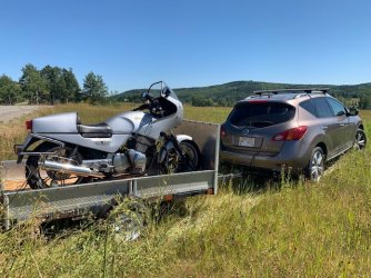

on the way home, still a ways out in the country outside the city, the bike "failed to proceed" and I had to have my spouse come and pick me up with my bike trailer. Long wait at the side of the road in the hot sun. Got the bike home and unloaded it, have not looked at it as yet.
was really pushing the bike hard for a couple of hours, lots of twisties, most of the time spent between 5,000 rpm and 8,000 rpm. At roughly 7,800 rpm in top gear, still accelerating hard in a corner, the engine suddenly revved hard to some ridiculous rpm and the bike lost all drive.
Coasted to the side of the road. Clutch pulls in and out like normal, feels normal. Lots of fluid in the master cylinder reservoir. No brake/clutch fluid apparent from the hydraulic clutch slave cover, looks nice and dry.
Would be nice if this failure to proceed does not necessitate an engine out crankcase split or something, I don't have the energy right now......
When I got the bike home, the engine fires right up, but moving the gear lever through the gears with the engine running gives clunks as the transmission enters each gear but does not produce any drive. The RGS is fitted with Kevlar clutch plates that have maybe 3,000 miles on them.
Anyway, anyone have any thoughts on what to look for when I start pulling the bike apart...??
