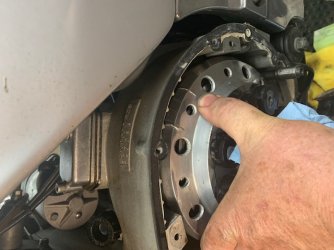

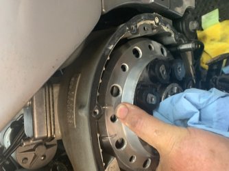

as I can't even get the RGS on to the center stand by myself since abdominal surgery, I enlisted the assistance of my youngest son, Marc, now 28. Some of you may remember him from all the rallies he attended with me at Wolfgang's over the years.
all kinds of granularish fiberish particles in the oil. Managed to actually get the bike into gear for real, now a connection between the clutch shaft and the drive chain sprocket, but with lots of play, lots more than I ever remember being there.
clutch stinks, steel plates are scorched bluish/black, about half the fiber plates are almost bald, granules of clutch friction material coming loose when rubbed, not much left on the fiber plates. Clutch has less than 3,000 miles on it since last replacement, bike has less than 8,000 original miles on it.
I am wondering if the loss of drive is that simple, that the clutch simply gave up under power after hours of continuous hard use?
Also, can the heavily scorched steel clutch plates be re used? Maybe sand them or bead blast them to clean them up? Or do I need to replace them with new? I am ordering all new fiber clutch plates.
the "slack" in the clutch shaft is way more than I remember. Look at the first photo, see the index mark? Then look at the second photo, that is how far the clutch basket and shaft can be rotated to the right before the front sprocket moves the drive chain to the rear wheel. The clutch basket is not moving on the splines of the shaft, the slack is in the connection between the clutch shaft shaft and the front drive sprocket on the other side of the cases. The front sprocket is tight on the splines. That "slack" can't be correct? Comments?

Hey Paul maybe the high engine revs you were experiencing was due to a huge amount of clutch slip? Possibly the springs didn't have enough tension allowing the clutch to slip at high engine speed, this would create huge amounts of heat destroying the friction plates and distorting the crap out of the steel driven plates you will find that they are most likely toast like the friction plates.
That amount of movement in the drive doesn't mean a lot as this will vary depending on what gear that the gearbox is in,  the lower the gear the more rotation of the clutch drum, its probably not slack but just the reduction in the gearbox.
