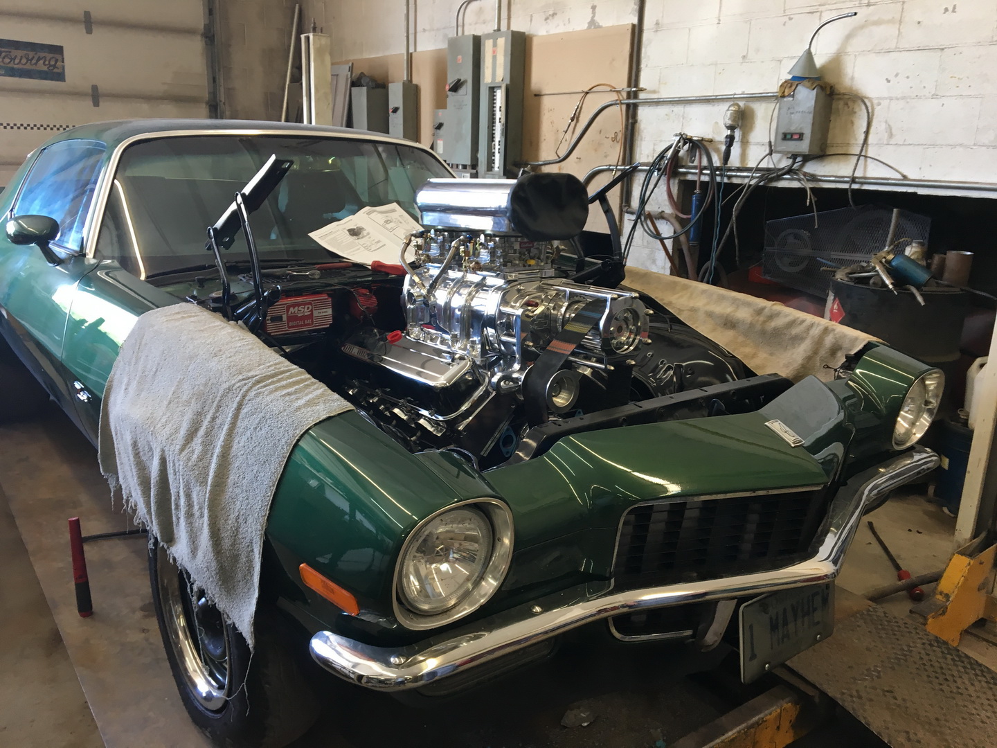

True 70 Z28 mounting a 625 Hp 7200rpm MKIV 460 SR BBC/M21/12 Bolt 273 12 Bolt Posi ;o)

Thing's kinda got out of control since I did not have the original 350 LT1:
