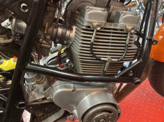

Laverda 500 Harris with inlet manifolds from a triple, rubber mounts and 40 mm dellorto’s.

so its not a GTL its a GTL with an SF1,2,or3 engine, we needed to know that in the begining, but you wer'nt listening to me where you Sean?, I told you the carbs were incorrect (as stock) and that the 750's never had rubber inlets, and that the mounting of PHF's has two options, the correct ones are pictured in post #8 and then you listened to all the others!!!!!!! the PHF's that you are seeking (solid clamp type) are VERY VERY thin on the ground, I told you that and why as well (again not listening) since you dont seem to want power, get a set of VHB30's as fitted to earlier 750's and Roberts your father brother.Much easier to obtain, but all used parts are dear these days.
Sorry Clem, I thought I’d been clear it’s a GTL fitted with SF1 motor. I had thought my issues were wholly due to getting 36’s into GTL brackets and frame. I hadn’t appreciated the different methods of mounting standard 36’s and the 36’s I have which came from a Guzzi. I thank you for starting my learning curve on that by pointing out that standard is clamp, where the 36’s I have are rubber connected. After the many knowledgeable contributions to this thread, including yours, I feel much better informed. I do have the original GTL VHB’s, and when the GTL motor has been rebuilt by Keith Nairn they may end up back on the bike, I’ll take his advice on that.
