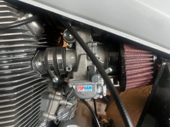

Good Morning, Had to buy a 3ft piece of the Gates Green Strip hose I used to attach my carbs. Would be happy to send a section to anyone on here for the cost of shipping.
