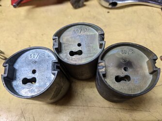

Did you try the 50/3 slide? I think a 50 cutaway would flow less air than a 60, therefore richer pilot jet needed to match the 60 cutaway. The 3 ramp is the longest ramp.
