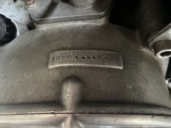

New owner of a 1000 3cl 1973.
PO imported from Spain to Denmark installed 4c cams and HC pistons.
Different motor serial number, year? See fotos.

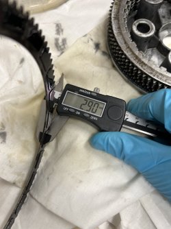

- opened primary case to check min allowed measure, plates 2,6-2,9 - springs 47-48.

The clutch plates sound a bit thick, should be around 2.6mm max. 7 x 0.3mm = 2.1mm, this adds up to a lot of extra travel required to deploy the clutch. Thickness of plain plates? There's not much room for any great deviation of the total lever travel inside the sprocket cover and you only have a window of around 10mm where everything chimes in nicely. The thinner the plates, the further the pushrod protrudes from the mainshaft, allowing for maximum lever movement.
