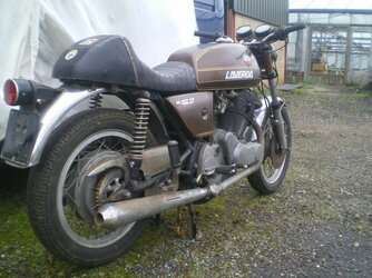

Well I took the SF2 project I paid far too much for to Ged at GCS and he started stripping the engine. In his opinion it is completely Donald Ducked. It's a shame because it has done very few km and it's the first time the engine has been opened but he estimated the rectification cost to be very high. It isn't economically viable to fix it so it's probably had its chips. Condensation inside the engine has devoured it. The castings are good but that's about it, although the starter motor still works :)
I have a couple of choices, selling isn't an option because I won't get my money back so I am thinking of taking everything from the bike that is compatible with a 3C making myself another wire wheeled triple and selling the UK registered SF2 rump for what I can get or scrounging up some SF2 engine parts and restoring it. It seems to be no decent crank, no dice.
Has anyone got anything I could use at a price that would be viable?

It sure is, it's a shame because apart from the crap brown paint it's very original and unmodified. Anyway, no use crying over spilt milk.

Yes I took a punt on it and lost. I have had lots of engines with the pistons seized from standing for years but usually the bottom end and cams etc are fine, this is in a different league. We took the head off yesterday and even inside the head top cover it was bunged up with powdered rust. Ged is going to take the bottom end to bits next week but looking at the state of the main bearings he said it looks very bad.
I don't know where it was stored, maybe in a sauna.
I bought it because I fancied just getting it up and running, cleaning it up a bit and having a bit of fun on it, I didn't intend to restore it.

I don't have the facilities Julian, I'm in a flat with a communal car park for a workshop. I will see what Ged says when he strips the bottom end next week and if we can get a crank and other parts from somewhere at a reasonable price I will put it back together it. Thanks for your kind offer.

The opened up engine pic isn't my bike Clem. No blame attached to the seller either, I snatched his hand off.
Ged has my engine in his workshop at the moment.
