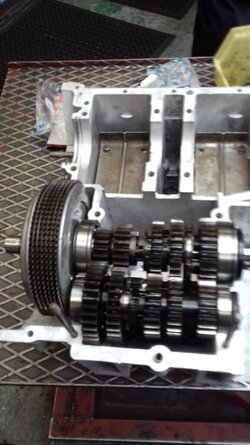

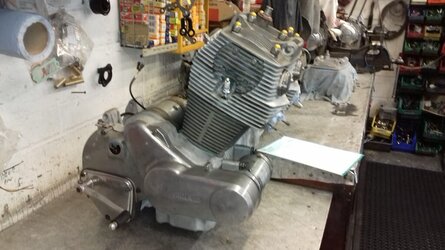

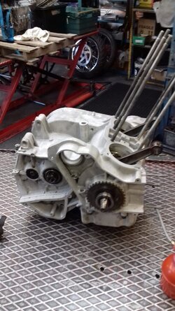

Ok, engine is now back together, I've already spent more than the bike is worth but what the hell. I should have nicked the bits to build a 3C replica instead of trying to rescue this heap . The cases are different shades of grey because the parts came from far and wide and I'm not prepared to pay for blasting etc. The internals are bang on, it has the original head (complete) amazingly, original barrels, crankcases and starter motor, maybe the dynamo, the rest was scrap.
Forks are away getting rechromed, tank is away being repaired.
Maybe it will live to fight another day?
