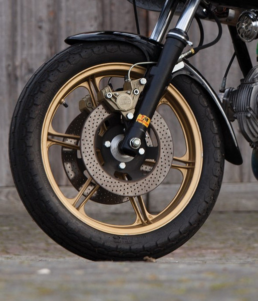

They had aluminium carriers from about 1981. Have a look at MHR or S2 models from about 1981, up until they ditched the bevel engines in 1985 (or was it 86?). They were the same 280mm diameter and same offset as the all iron disks, so were a bolt-on upgrade. I never checked the weight difference, but I presume the ones with the aluminium carriers are a bit lighter.
My 1985 MHR (below) has cast iron disks on Aluminium carriers.

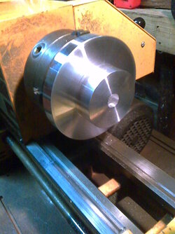

This is how I fitted 320mm discs to my SF2 hub ... no small amount of work. The underside is where it got really complicated. In hindsight there were many other easier ways to fit them plus the 22mm axle for the OW01 front end!! But I learnt a lot about my lathe and the finer points of machining (from very little base knowledge).
