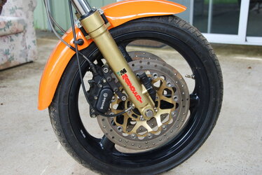

heres my cagiva GP500 conversion, just bolt on with calliper brackets from Red (I much refer the look of the protpotypes, rather than the production ones with CSK bolts)
the bobbins were crap when I bought the discs (just to try it all out) once proven oversize ones wer got for me by a French firm that makes them but wouldnt respond to an English email, then I got a second set of o/s bobbins as well, still wiatinf a duff set of discs, but found some new ones from a firm in the IOM that makes them, PVM? it may have been.
se picture, sorry I like the calliper ahead of the forks and this has not caused any problems over ten years and many miles.
