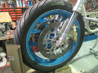

When we built Mike's Mk3 Motodd we used Ducati Multistrada Showa upside down forks mated to 1986/7 Slabside GSXR 18" rims so we had to machine our own brake rotor carriers as they were a custom offset, bolt patter which we did to match a 320mm Ducati rotor using the Ducati carrier design as the basis
Went over to Metalgear and the owner Bernie told us that we were the very first customers that he had ever had that turned up with custom machined rotor carriers to have rotors fitted to them
He gave Max and I a guided tour of his set up, not a bad at all
