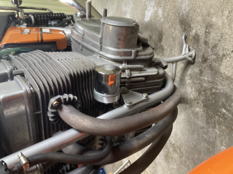

Hi,
I didn’t read all the comments, so I don’t know what was said about Magnefine. For me, it’s been reliable and simple to use. At the moment not in use, waiting for the next oil change.

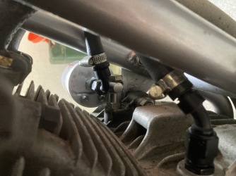

I recently fitted a filter from a CRF1100 on LH side engine mount using an own design aluminium adapter, stainless steel bracket and engine adapters. So far only been on for 250 miles. The concept of adding such a filter is fine, my only concern is that vibration may cause leaks to slowly develop. Will be running the bike down to Breganze this weekend and then the plan is to travel up to the UK before back here to Bavaria. Should prove to be enough of a test. Assembly is okay, a few steps required, but quite straight forward. Filter change is a doddle and very little oil is spilt. Biggest concern is someone tampering with the filter! Drawings need some updating, but would be happy to share once that is done.

That is very elegant - I'd be curious about vibration too. What is the filter adaptor?
Adapter is own design. So far 600miles and vibration has had no detrimental effect. I will be modifying the design to reduce fluid fittings by 1 and of course seals by 1. And change bracket to increase its stiffness plus eliminate slight fore / aft rotational movement around the axis of the 2 screws in vertical plane by adding a third screw in the fore / aft plane
