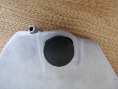

It is possible Cam, not rivet-counter-perfect though, as the kidney shape extends beyond the round hole. Here are some pics to show a standard round rubber cover versus the kidney hole. The lip of the cover would just about cover the irregular hole shape.

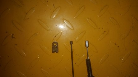

Paul, I am sure you are well aware of this, however, just to be sure, if you have an early 750 you need to change the clevis to accept the much larger nipple on replacement cables. For interest purpose I have attached a piccy showing the original small nipple cable and clevis along with replacement cable with larger nipple. Obviously cannot fit and larger clevis is the easy way to go. (Apologies for stating the obvious, but others may not be aware......... :-[)
Where the hell does that replacement clutch cable come from?
