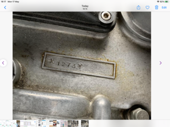

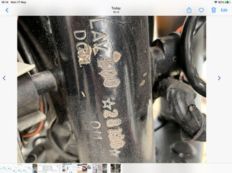

I am thinking of buying a 1977 Alpino to join my Monty. The frame number is 28120 and the engine number is 1273.
Can anyone think why this should be so far out? any pearls of wisdom would be appreciated. TIA

Thank you, I am sure the frame numbers didn't go this high but I have checked the frame number and 28120 is definitly the number showing.
I thought maybe the frame had been damaged sometime and a replacement frame had been supplied!!
28120 is not a Laverda 500 frame number, in fact it's not a Laverda frame number.
Engine has been changed if that number is anywhere near the frame number. 1273 would be a non balancer engine.
definetely not a laverda frame number and if a replacement frame had been supplied, there would only be enough space for the four digits that it will have, between the stars, they would have been blank, the number should be LAV.500*????* with number digits between the stars. Engine numbers on 500's that have been changed are usually easy to spot, the number is on a sqaure sunken section of casting, it would be more difficult to change because of the ridge that is all around the number, they get changed on other Lavs as well, and are more easy to do, but usually you can still spot because of the unusual font that Laverda used on some of the digits, not saying publicly which ones.

The engine # is consistent with an early Alpino but the date of the frame is anybody’s guess. Is this a UK or imported bike?
I am also curious why the numbers are missing from the homologation stamping. Surely they would have been included even if the frame was supplied as a replacement? I am aware that Slaters imported bare frames with no chassis # but I thought they had a complete homologation stamp.
However, if the homologation stamping had been complete I would have been more inclined to question whether it was a frame from a stolen or written off bike and someone had tried to hide its original identity.

strip the paint using Nitromors and very fine wire wool and look again.
