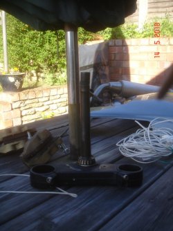

I bought this 668 which had been involved in a head on collision whilst being transported in a van. It came loose and impacted the partition between the driver and the rear. Twisted frame and yoke stem as Piet describes.
